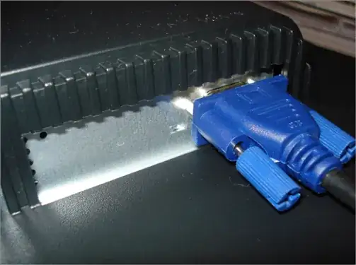

I bought a new monitor (Acer X203H) and wanted to plug it into my graphics card but on my graphics card one plug says CRT which is already filled with the first monitor and the second says DVI, which I don't have a cable for on my second monitor.

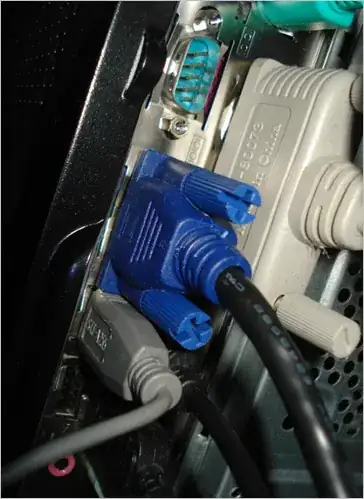

I found what looked like a VGA outlet on my motherboard and plugged it in:

I've also read in some reviews that the Acer X203H is supposed to have DVI support, but here is a picture of the back of my monitor where I plug in the cable, it looks like there is a place for a DVI cable but this particular model doesn't have one. Ergo, I think my best bet is to get a VGA-to-DVI converter as Will suggested.

  • @Will, by "DVI cable" I assume you mean a VGA-to-DVI cable, right? Since as the last picture above shows, the monitor seems to have a physical area for a DVI out port to be, but mine doesn't seem to have this out port. – Edward Tanguay Oct 21 '09 at 05:47
The issue is that you are using a video card, so the VGA port on your motherboard is disabled. I wouldn't expect the monitor plugged into the motherboard to be recognized even, but I suppose it's possible.

  • +1: Most motherboards won't allow you to use on board and a video card at the same time. Your best solution is to use DVI as mentioned in this answer. – EvilChookie Oct 20 '09 at 20:37
According to the specs the Acer X203H does have DVI, a quick look should confirm that. In that case the best solution would be a DVI-DVI cable.
The second option would be a DVI-VGA connector, but first verify that your Graphics Card supports 2xVGA. The DVI ports come in different flavors, analog VGA being an option. From the picture I would say you're OK, but a DVI cable is the safer bet.
And Acer is being cheap, not including a 2nd cable. Did you check the box again?
