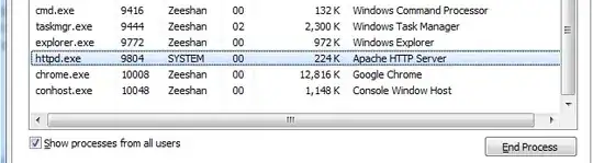

Use this command: netstat -o -n -a | findstr 0.0:80 to check the PID of the process using port 80. If port 80 is free, nothing will appear in result. If any process is running on port 80, you will get its details. enter image description here
Now you can check from task manager the process running under this PID. enter image description here

  • Well, try checking which process is it from the task manager (enable PID column first from View > Select Columns). If it is svchost.exe, right click on it and select "Go to service(s)" option to view the services using it. – Zeeshan Apr 17 '13 at 17:09
  • ok it is pid 4 .. and it belongs to "system" :( – Sven Koluem Apr 17 '13 at 17:17
