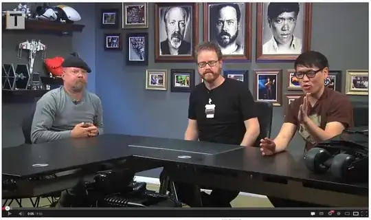

This is the video in Chrome. I opened it and paused it at the 0:05 mark and left it loading for about a minute. We can see the result in the scrub bar:
YouTube video in Chrome
Here is the same video after the same period in Firefox:
YouTube video in Firefox
A couple more minutes later, and the video is fully buffered in Firefox while the situation in Chrome is unchanged.

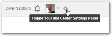

Disabling Dash playback
To disable Dash playback, just open the settings menu:
And untick the corresponding checkbox on the player page:
The result will be that videos will load as fast as possible and fully.
