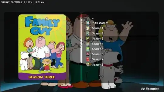

Another alternative would be XBMC, a complete media center solution:
Or Plex, which does just the same:
Those should be able to import almost any file, since they rely upon the FFmpeg container and codec libraries.
