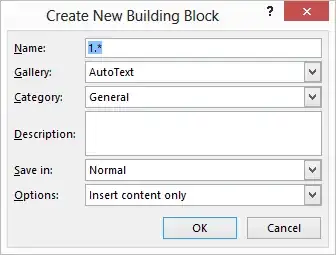

  7. Press Alt+F3. Word displays the Create New Building Block dialog box.
  8. In the Name field enter a name by which you want this highlighted text known. This should be something short and meaningful, such as NumList or even NL (Rodolfo: or nF if you are numbering figures).
  9. Click on the OK button. The dialog box closes.
