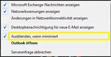

I normally do that with the built-in features of Windows and Outlook.
Please excuse the German screen-shots. I'm in a non-Enterprise, non-MUI environment. I have added as much information as possible to ensure you can perform the tasks in an English environment.
Outlook shortcut
  • Right click on your Outlook icon and select the Shortcut register.
  • In the Shortcut register go down to the option Run: and select the option minimized.
  • Press OK to close the Outlook properties.
Outlook shortcut properties
First start of Outlook
  • When you start Outlook for the first time, right-click on the Outlook System Tray to bring up the options.
  • Select the option Hide, when minimized (highlighted with a yellow border in screen shot)
Outlook system tray context menu
Restart Outlook
  • Close Outlook and wait for the system tray icon to disappear.
  • Restart Outlook and enjoy Outlook minimized.
I have tested this personally on with and it works, with one limitation: Outlook starts minimized in the task bar at first.
Workaround
  • Maximize Outlook once
  • Minimize Outlook once
  • Outlook is in system tray
