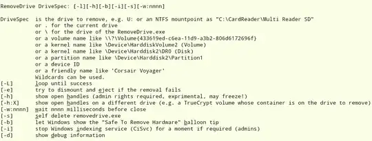

RemoveDrive can be used from a batch file:
You can use drive letters or "friendly names". If you want to make the batch file truly generic you can copy the exe (it's really small) to all your removable drives. Then you can simply loop through all drive letters and if RemoveDrive.exe exists execute it using removedrive \ (which will eject the drive the exe is on). Better still, you can loop through and eject only mounted devices using the batch file I posted here.
