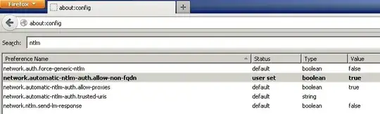

I know I can add specific URLs in the network.authmatic-ntlm-auth.trusted-uris and separate them by comma delimiters, but I would like to enable NTLM for all intranet sites. I tried http://* and http://. but that didn't work. Also, some of the intranet sites are https.
Update
  1. Set network.automatic-ntlm-auth.allow-non-fqdn to true
  2. Set network.automatic-ntlm-auth.trusted-uris to blank

You don't have to put specific URLs in the list — you can put entire domains. So, for example, adding mycompany.com should enable NTLM for mail.mycompany.com, monitor.mycompany.com, intranet.mycompany.com, &c. (You might need to do .mycompany.com with a leading dot, actually, i can't remember — and my current job doesn't use NTLM, so i can't test.)
You can also tell Firefox to enable NTLM for any site that doesn't have an FQDN (fully qualified domain name); this is useful if your company just uses http://intranet or something similar. To enable this, set network.automatic-ntlm-auth.allow-non-fqdn to true.

  • we don't use FQDN for intranet sites, so i'll try it out when I have a chance. thank you! – Ray Cheng May 11 '13 at 01:11
    @kine's first suggestion was right, I didn't have to use a leading dot or wildcards to get mycompany.com and all subdomains like dashboard.mycompany.com added. – David McClelland Dec 02 '13 at 15:54
    For anyone confused why entire domains aren't working like I was, using just `mycompany.com` doesn't work. You have to use `http://mycompany.com`. – Tarka Oct 06 '15 at 17:15
I tried everything, but the thing that worked was setting network.authmatic-ntlm-auth.trusted-uris to domain.com
Thats all you have to do. Trying to do individual websites like http://website.domain.com didnt work. Just use the domain name
