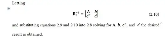

How do you create equations in Word 2010 that are automatically numbered with the equation number centered vertically on the equation and right justified? While a number of references have discussed the use of three column tables, finding a step by step procedure kicked my butt for some time.
Example Equation with Numbering

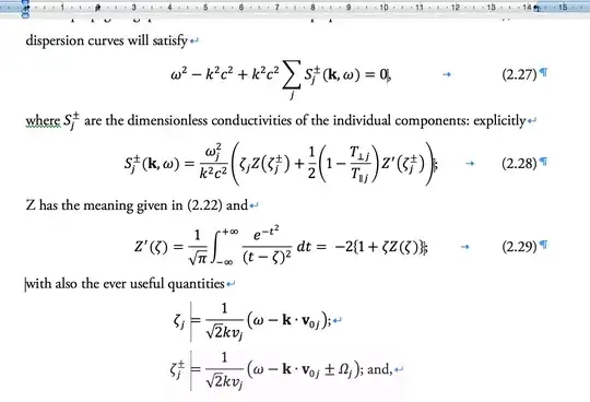

This is a perennial question so I hope you will not mind me submitting another answer.
The problem with the "table" approach is that it breaks the paragraph. This can cause spacing issues if your equation is part of a continuous sentence and your paragraphs have spacing before or after them. It also means that wrapping is done rather poorly for long equations (the usual preference in journals is that, if the equation is the width of the column, the number should appear below the equation right aligned instead of breaking the equation). Finally it does nothing to solve the problem that you wish to have punctuation marks instantly after your Display equation in the normal paragraph font.
My solution is to insert a style separator instantly after the equation. On Windows, use Ctrl-Alt-Enter to insert a style separator. (On a Mac this is not available, but if you open a document created in the Windows version of Word you can copy the style separator into Mac). Then you may insert a tab (with a final right-aligned tab stop already created) and the appropriate equation number autotext. After the equation number you should insert a full paragraph break and not a line break, but at least in Word 2012 the paragraph break is treated as though it were a line break for layout purposes. This may be a bug.
If you want your equations neatly aligned at the equals sign, this is, to my knowledge not possible using this work-around. One way around this is to write your punctuation inside the equations, inside double quotation marks. The Equation tool converts this into free form text which may be placed in whichever font you prefer. I also use this method when I want several small display equations on one line separated by commas or the expression ", and ". However, you cannot number these equations, or at least you can only number the final equation in the set.
The result, with hidden paragraph marks on, looks something like this. Microsoft Word 2012 some equations
[Note I have also changed the default behaviour of line breaks in fully justified text so that the final line before the line break is not fully justified.]
The style separators here are the thin dotted lines at the end of equations (2.27)–(2.29). Mac Word does not have the proper glyphs to display style separators with a proper picture as you would find in Word for Windows.
Inserting a line break instead of a paragraph break after the equation number seems to cause buggy layout behaviour on my machine.
Unfortunately the end of the sentence after your equation, on the new line, looks as though it is a fresh sentence to the spelling and grammar checker, probably because of the paragraph mark. I have accepted this and resorted to using "ignore" very frequently.
There is a final caveat: when referring to the equations later, the tab before the equation seems to show up with the reference number. You can avoid this by giving an explicit field switch of the form \#(0.0x);(0.0x).
I have been using this approach in a document I am writing which is now up to 160 pages containing a few hundred equations so I think it is relatively robust, once you get it to work.

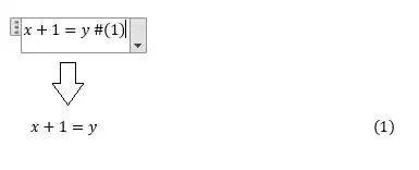

This solution does not take care of automatic labeling and assigning captions, however, I believe it will be quite useful to people looking at this thread. Adding a number to an equation is way more simple than what the existing answers suggest. All you need to do is append the equation with a #label, for example:
x + 1 = y #(1)
will get rendered as x+1=y with (1) on the right (See the picture).
For more documentation on MS Word Equations I recommend http://www.unicode.org/notes/tn28/UTN28-PlainTextMath-v2.pdf, it is an extremely useful document!
The screenshot is taken in MS Office 2016 but the document itself is from 2006 so I expect this works for sure in MS Word 2007 and newer.
