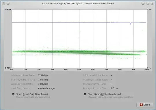

I have a Sandisk SDHC 4GB Class 2 memory card, and I have benchmarked its reading speed with Palimpsest Disk Utility, under Linux and with my Acer Travelmate 5720G laptop.
These are the speeds when it is inserted in the builtin card reader of my laptop:
While these instead are the values obtained while using an external USB reader (similar to the one in the image at the bottom of this question):
As you can see, in comparison with the USB reader, the speed is basically halved when using the builtin reader, and this behaviour sounds strange to me.
Shouldn't be the builtin reader be faster, or at least of equal speed? After all, with the external USB reader there is at least one extra step if compared with the builtin one.
I thought that the bottleneck was caused by the USB reader, but apparently it is not the case.
EDIT Here are the specs of the SD reader
