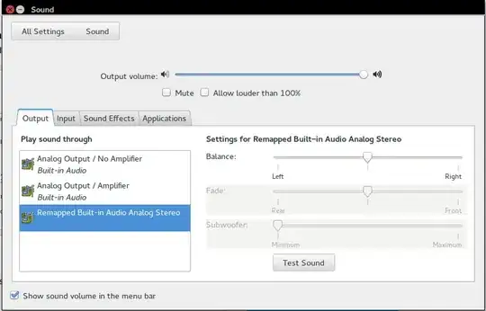

This will create on the fly an additional PA sink with reversed channels. (It will disappear after pulseaudio restart). To switch to it:
pactl set-default-sink reverse-stereo
— OR, you can also switch manually via the sound control panel:
pulseaudio volume control window
Off course it's possible to switch back and forth, e.g. when experimenting.
