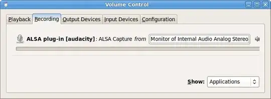

Your hardware does not support capturing its output; once the data has gone into the actual playback device, it's gone.
You need to use some software that duplicates the audio data before it is written to the hardware.
I'd suggest using PulseAudio; there you can simply select one of its outputs as capture source: pavucontrol output monitoring

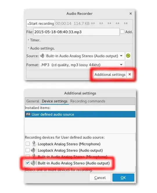

  1. Go to PulseAudio Volume Control -> Input Devices Tab. At the bottom, choose to show "ALL input devices". Check if "Monitor of Internal Audio Analog Stereo" is not muted and the volume going up and down as you play the audio!!
  2. Use Audio Recorder to record Audio Source = Internal Audio Analog Stereo (Audio Input). See screenshot below.

I have just installed audio-recorder: https://launchpad.net/audio-recorder which in its options show what you need...
