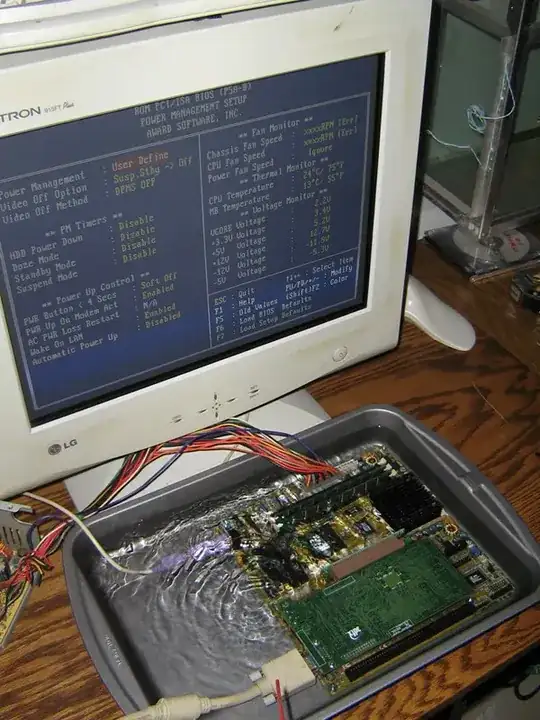

It's apparently safe to immerse entire devices in isopropyl alcohol—it seems to be a common way to save 'dead' cellphones—but I wouldn't recommend it as you'll see. It probably won't damage electronics; this thread on the HP calculator forums talks about immersing an entire calculator in alcohol, though with no follow up on whether it works.
via here - no idea on the original source.
And this is allegedly an entire PC soaked in rubbing alcohol. (No, do not do this. isopropy alcohol is highly inflammable - it will evaporate into something that can be ignited at low temperature (13-15 degrees), and will catch fire at around 400 degrees C, and we do not want to be responsible for house fires. BAD BAD IDEA.) And since this is kinda being mentioned in the comments (Its potentially explosive under the right conditions - I do not recommend trying to blow up plastic water jugs unless you're a trained professional and/or a chemistry teacher).
It will, however, probably dissolve things like thermal paste (which can be conductive, especially in formulas that contain metal.) As such, you don't want to be using it in bulk (by spraying or dipping a whole panel.) Additionally, it's a bad idea to combine it with grease, since you might end up dissolving some minor thing—conductive stuff in CPU sockets is bad, as would be accidentally removing all the lube from the mechanical parts of a drive. It'll also loosen any stickers present on the hardware. Apparently it also does nasty things to plexiglass and Lucite, so test before you clean any plastic bits.

  • Regarding the immersion of a HP calculator in isoprop... I didn't dunk mine completely, but used a good portion of it for cleaning purposes. It worked, but it needed several weeks until all keys were responding again. The alcohol obviously crept easily into the encapsulated keys, but took its time to evaporate completely. – mpy Sep 02 '13 at 11:15
    -1 The picture is probably a fraud - very conveniently it doesn't show if the video cable is connected to the monitor - so it only incites people to take too much liberty with a very volatile substance. You detail some practices of yours, but no references to show whether they are safe or correct. "It works for me" weighs less than advice by manufacturers of cleaning materials. – harrymc Sep 02 '13 at 12:54
    I think you missed the two paragraphs below that stating why its a bad idea, and some of the things to watch out for. I would think the 'allegedly' and the capital letter bad idea would be obvious enough. – Journeyman Geek Sep 02 '13 at 13:49
    I think showing such a sensational picture of what is essentially a potential bomb is irresponsible and dangerous, whatever the text says, but it's for you to choose whether to keep it – harrymc Sep 04 '13 at 08:26
    That would make an astoundingly poor bomb. – Falcon Momot Sep 04 '13 at 09:01

  • @FalconMomot: Alcohol vapor is explosive when mixed with air in amounts ranging from 3-19 percent by volume, at room temperature and atmospheric pressure. – harrymc Sep 06 '13 at 06:02
  • This is most certainly not alcohol but mineral oil. Mineral oil does not evaporate, does not ignite, is a very good insulator and works very very well at cooling computers :) –  Sep 06 '13 at 13:57
  • @Gael: [Wrong](http://en.wikipedia.org/wiki/Isopropyl_alcohol). – harrymc Sep 06 '13 at 16:03
  • I can't access the website. Alcohol seemed such a dumb idea that I thought it was only mineral oil. But I was wrong: Google cache is a lovely friend. Oh and BTW, I know what isopropyl alcohol is, hence my reaction. –  Sep 06 '13 at 16:15
