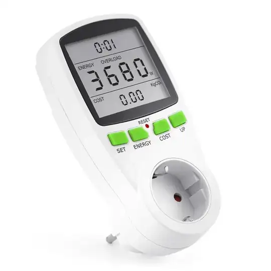

The best way to find out, use something like this:
