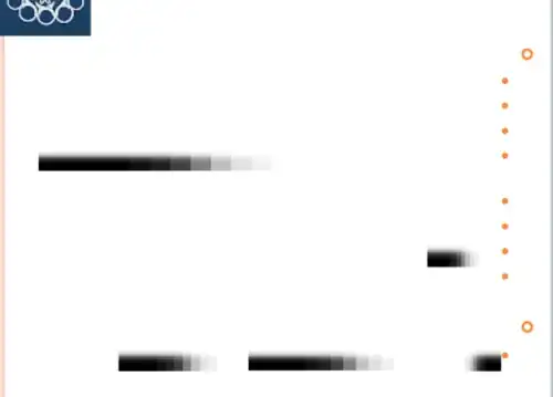

I have PowerPoint slides with visual effects on them, so each line appears after clicking on the screen in the presentation. When I convert them to PDF the slides are mostly empty and only some titles are in them and the lines that had the visual effect don't appear.
They come out looking like this:
powerpoint slide with animations
How can I convert them to PDF properly, without having to go through all of the slides (there are like 200 of them) and removing each effect?

  • Do you see all of the slide info if you try to print one? – daalbert May 31 '13 at 16:28
  • Have you tried it yet? What happens when you convert it? – CharlieRB May 31 '13 at 17:21
  • As I said -> "When I convert them to pdf the slides are mostly empty and only some titles are in them and the lines that had the visual effect don't appear on them." the numbers, titles, lines without animations appear. my most important lines are not there – Peggy May 31 '13 at 19:08
