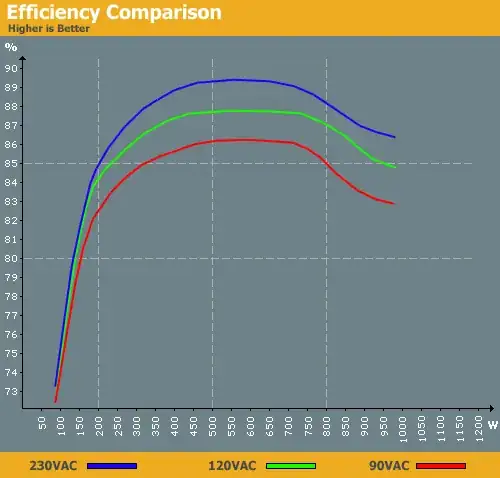

If you take a look at some PSU efficiency curve (from AnandTech) :
Cooler Master UCP 900W efficiency curve
You'll see the efficiency is not a constant value, it varies a lot depending on the load applied to the PSU. You'll see on that 900W PSU that at low power (50W to 200W), the curve is so steep that an increase in the load will entail a substantial increase in efficiency.
If the increase in efficiency is high enough, it would mean that in some cases, your computer may not need to actually draw an extra 5W from the wall socket when you're drawing an extra 5W from a USB port.
Let's take an example of a computer drawing 200W on a PSU with an actual efficiency of 80% at 200W :
Computer power consumption : 200W
USB device power consumption : 5W
PSU efficiency at 200W  : 80.0%
Wall power consumption without USB : 200W / 80,0% = 250.00W
Now, depending on the efficiency curve of the PSU between 200W and 205W, the relative power consumption of the USB device may be completely different :
<Case 1>
PSU efficiency at 205W  : 80.0%
Wall power consumption with USB : 205W / 80.0% = 256,25W
Wall power consumption of the USB device : 6.25W
This is the usual simplified case, where the efficiency is the same, hence the power consumption of the USB device is equivalent to 5W / 80.0% = 6.25W
<Case 2>
PSU efficiency at 205W  : 80,5%
Wall power consumption with USB : 205W / 80,5% = 254,66W
Wall power consumption of the USB device : 4.66W
In this case, the PSU efficiency is increasing between 200W and 205W, thus you can't deduce the relative power consumption of the USB device without taking into account the whole computer power consumption, and you'll see the relative increase at the wall socket may actually be lower than 5W.
This behavior only happens because, in that case, the PSU is under-loaded, so it's not the usual case, but it's still a practical possibility.
<Case 3>
PSU efficiency at 205W : 82%
Wall power consumption with USB : 205W / 82% = 250,00W
Wall power consumption of the USB device : 0W
In this case, the PSU draws the same power from the wall socket, whatever the load it receives. This is the behavior of a zener regulator where all unnecessary power are dissipated into heat. It's a behavior that can be observed in some kind of low-end PSU at very small load.
<Case 4>
PSU efficiency at 205W : 84%
Wall power consumption with USB : 205W / 84% = 244,00W
Wall power consumption of the USB device : -6W
That last case, is a purely hypothetical case where the PSU would actually consume less power at higher load. As @Marcks Thomas said, this is not something you can observe from a practical power-supply, but it's still theoretically possible and proves that the instinctive TANSTAAFL rule cannot always be applied that easily.

    I don't think any practical power supplies have a sufficiently steep efficiency curve to actually reduce consumption under increased load, but +1 for making the very relevant point that a computer can be more efficient than a wall charger. – Marcks Thomas Jun 06 '13 at 11:38
    @MarcksThomas I don't think either, but it's theoretically possible and it would be easy to build a dummy inefficient PSU that behaves this way. I was just making the point that the simple *TANSTAAFL* reasoning only works if you don't take into account the fact that the computer PSU may already draw power that you're not using. The overall consumption won't obviously decrease, but I wouldn't be surprise if it doesn't increase as much as expected. – zakinster Jun 06 '13 at 12:06
    If you start using an extra 5 Watt to charge a device your computer is likely to draw an extra 6 Watt from the wall socket. (That is 5 Watt plus inefficiency of the PSU, where an average PSU is roughly 80% efficient). A separate charger might be less efficient, especially if if it left plugged in 24/7. This is because even when not in used a charger tends to consume some power. Not much, but 24 hours per day times not much will add up. (Not that the OP asked for that much detail. :) ). – Hennes Jun 06 '13 at 13:52
  • @Hennes It's indeed likely that an extra *5W* on the *+5V* intails an extra *6W* on the wall socket. But if you take a PC drawing *200W* with a PSU efficiency of *0.8* at *200W* and *0.805* at *205W*, the *+5W* would actually draw on the wall socket *205W / 0.805 - 200W / 0.8 = **4.65W***. And it's not a very unlikely efficiency curve for a powerful PSU. – zakinster Jun 06 '13 at 14:43
    @zakinster If a PC draws 200W with 80% efficiency, it will draw **250W** from the wall (since 20% is lost in PSU conversion). Adding 5W to the PC's draw amount gives 205W drawn, and at 80% efficiency this gives **256.25W** drawn from the wall (or an additional **6.25W**). – Breakthrough Jun 06 '13 at 15:27
    @Breakthrough Completely true if the efficiency is a constant *80%* at *200W* and *205W*, but I specified in my example that the PSU efficiency was actually *80,5%* at *205W* – zakinster Jun 06 '13 at 15:35
  • @zakinster, you need to change your second example so that your theoretical PSU is drawing 200 @ 80% in the first scenario; right now, seeing the wall consumption decrease as a result of going from 205W @ 82% to 205W @ 84% is entirely unremarkable. :-) – Hellion Jun 06 '13 at 17:05
  • @Hellion actually it's two variants of the first senario, I'll edit to clarify. – zakinster Jun 06 '13 at 17:09
  • @zakinster, ah, I see what you were going for now, thanks. – Hellion Jun 06 '13 at 17:36
    This is totally misleading. It does not matter if you need 4 or 6 Watts of power input, the answer to the question is always yes. There is not a single power supply where the efficiency jumps by orders of magnitude if 5 Watts are additionally drawn. Look at your own graph, over a range of 1000 Watts a mere 17% change in efficiency has been measured. – Alexander Jun 08 '13 at 13:16
  • Ah sorry, I didn't see that you had changed the efficiency value... However, I wanted to illustrate that indeed the computer would use more electricity, even in that example I highlighted (even given the efficiency change, you **will** still draw more power from the wall - and indeed, a 5W change is negligible [even given a 250W supply, that's only a 2% change] enough that the efficiency wouldn't increase enough to outweigh the increased load - and that *already* assumes you're on the lower half of the efficiency curve). I agree with @Alexander that this *is* misleading, for these reasons. – Breakthrough Jun 09 '13 at 06:41
  • The long answer did indeed explain the concerns in my last comment; however, the previous short answer did seem to be somewhat misleading. I edited the answer to better reflect these concerns, and to better indicate the full implications of the "long answer" (specifically, there's no *free* power here). – Breakthrough Jun 09 '13 at 06:53
  • What a fascinating answer. I really appreciate you guys going the extra mile on this – arnehehe Jun 12 '13 at 08:07

What did @zakinster miss?
With the greatest respect to @zakinster, he has misunderstood the nature of efficiency. Efficiency is a consequence of the relationship between input power, loss and output power, and not a physical quantity for which input power, loss and output power are consequences.
To illustrate, let's take the case of a power supply with a maximum output power of 900W, losses given by Pl = APo² + BPo where A = 10^-4 and B = 10^-2, and Pq = 30W. Modelling the efficiency (Po/Pi) of such a power supply in Excel and graphing it on a scale similar to the Anand Tech curve, gives:
This model has a very steep initial curve, like the Anand Tech supply, but is modelled entirely according to the analysis above which makes free power absurd.
Let's take this model and look at the examples @zakinster gives in Case 2 and Case 3. If we change Pq to 50W, and make the supply perfect, with zero loss, then we can get 80% efficiency at 200W load. But even in this perfect situation, the best we can get at 205W is 80.39% efficiency. To reach the 80.5% @zakinster suggests is a practical possibility requires a negative loss function, which is impossible. And achieving 82% efficiency is still more impossible.
For summary, please refer to Short Answer above.
