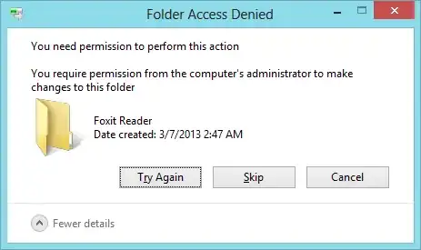

I tried to upgrade Foxit Reader and it left the directory in an unreadable state. I can't view the directory, nor even delete it, not even as Administrator. How do I get rid of it so I can re-install?
C:\Program Files (x86)\Foxit Software>takeown /f "Foxit Reader"
ERROR: Access is denied.
C:\Program Files (x86)\Foxit Software>takeown /a /f "Foxit Reader"
C:\Program Files (x86)\Foxit Software>icacls "Foxit Reader" /setowner Administrator
Foxit Reader: Access is denied.
Successfully processed 0 files; Failed processing 1 files

    Try to find out if any process has a file handle on it, among others you can use sysinternals process explorer. – Martin Jun 06 '13 at 20:08
The problem was Brother Control Center had a lock on the file. I don't know why Brother Control Center was running - I did not run it, it does not start at boot - but it had a lock. I killed the process and the directory disappeared. I found the lock with 'Process Explorer' and searched for 'Foxit Reader'. There were two locks for the same process, 'BrCtrlCntr.exe'.
