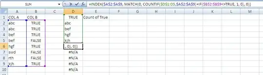

You can use the following formula to list the values from Column A that have "TRUE" in column B.
In Cell D2 enter this array formula with CTRL+SHIFT+ENTER and drag it down to display all the uniques that meet the condition...
=INDEX($A$2:$A$9, MATCH(0, COUNTIF($D$1:D1,$A$2:$A$9)+IF($B$2:$B$9<>TRUE, 1, 0), 0))
Edit* Added a Photo. enter image description here
Scheballs
  • 403
  • Any reason for that $D1:D1 which is not part of my range? – Andrea Moro Jun 14 '13 at 13:44
  • When you drag the formula down that range (which is the cells above it) is used to identify what has already been returned so it won't return a duplicated value. See the photo I added to my answer if it helps. – Scheballs Jun 14 '13 at 18:10
