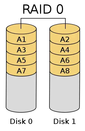

A RAID-0 configuration utilizes 2 separate hard disks and writes "chunks" of data to each one to minimize actuator movement and read/write data faster (each arm does half the work in a sense). The caveat with this is that there is a lack of fault tolerance - if one drive dies, all of your data is gone. And since there is 2 drives handling your data, the chances of losing your data is basically doubled. You may want to look into RAID1+0, which give you speed benefits as well as fault tolerance. You can swap in another disk upon failure and have the other disks rebuild it.
The RAID-0 image from wikipedia domonstrates it well:
alt text
imagine the disks are showing a file called A.txt. Now, imagine each section as a 4096-byte cluster for example. Each disk is holding roughly 16384 bytes of this text file, and if one disk dies, there is no way to recover the other half.
