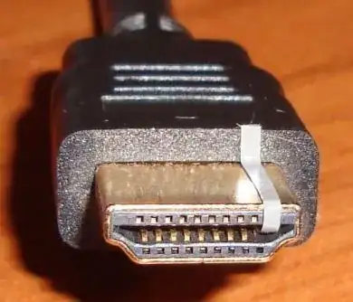

The one solution that more than one person found to work, was disconnecting pin 19 of the HDMI cable (you might consider buying a cheap cable for testing) :
