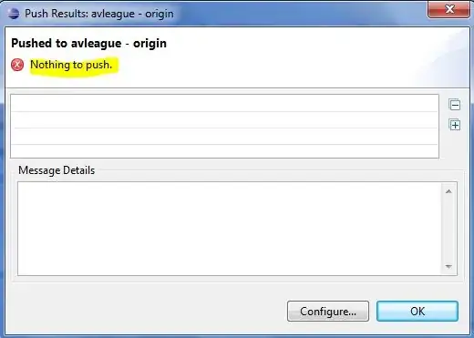

My workspace has few changes that I want to push to github. I've already commit'd them. Wen I try Push from eclipse, I get the below
I am not sure what I am doing wrong

    It looks like maybe you are not on a branch? So maybe egit doesn't know how to push to origin. A local branch usually has remote tracking set up which specifies how to push to origin. If your HEAD is currently detached, there is no place to find upstream tracking information. –  Jun 14 '13 at 04:36

    I'm guessing that your goal is to push your two new commits to `master` on origin. Normally, the situation you want to be in for doing that is to have your local `master` checked out, and have your new commits on your local master, making your local master be 2 commits ahead of origin/master. Once you're in that situation, you would be able to push. So how do you get there? You need to check out your master branch, then reset it to 327de48. –  Jun 14 '13 at 05:01
Looks like you've created your new commits while not being on the master branch - your HEAD and MASTER are pointing to a different commits. All you have to do is to merge you new commits into MASTER. Here are the commands:
git checkout master
git merge 327de48
Once your new commits are in the master your push should work, because git will see the difference between local and remote master.
