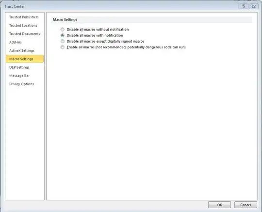

  • On Access 2007 , go to the Windows thingy on the top left, chose Options, at the bottom of the list you'll find sthg like "Security center" or "Confidentiality center" (my version is not in English), once you click on that there will be a button with parameters, click on it and change the security settings of Macros. That should do the trick. – P. O. Jun 19 '13 at 15:15

Another way to fix this is to create a Trusted Location for your project. you can use a registry key to make your folder a Trusted Location. This is actually easier then is sounds once you know what key to set.
The registry key is slightly different for each version of MS Access, but here is a sample key for MS Access 2010:
[HKEY_CURRENT_USER\Software\Microsoft\Office\14.0\Access\Security\Trusted Locations\Location20] "Path"="C:\Database\" "Description"="My Database location"
If you copy and paste the above quote into a text file and save it with a name such as RemoveSecurityWarning.reg, you can then run (merge) the file into your computers registry by simply double clicking the file.

Access 2010 automatically safeguards against all macros unless you tell it otherwise. It also will disable content of files which it doesn't trust. You must tell it which ones to trust via the Trust Center.
In Access 2010, the Trust Center controls what content is allowed and can be accessed by File > Options > Trust Center > Trust Center Settings button.
Within the Trust Center, you can change macro settings and add files and locations to the trust settings.

Another way to do it is performing a registry change to a specific product location that will do it to all access databases as well as for Excel or Word. There is a value known as VBAWarnings that by default has the value set as 2 and when you change it to 1 the yellow ribbon will not be displayed.
If you are using C# use the following code:
using Microsoft.Win32; // for required for registry reading/writing
// Opening the Registry Key
RegistryKey rk = Registry.CurrentUser;
// Open the corresponding Subkey
// I have to use CreateSubKey
// (create or open it if already exists),
// 'cause OpenSubKey open a subKey as read-only
RegistryKey sk1 = rk.CreateSubKey("Software\\Microsoft\\OFFICE\\14.0\\Access\\Security");
// Save the value to change Macro Settings in Security Warning
//sk1.SetValue("VBAWarnings, 4); //Disable all macros without notification
//sk1.SetValue("VBAWarnings, 3); //Disable all macros except digitally signed macros
//sk1.SetValue("VBAWarnings, 2); //Disable all macros with notification - Default Office Setting
sk1.SetValue("VBAWarnings", 1); // Enable all macros
This code is strictly and directly for Access 2010 but it can be changed to cycle through the registry including products. Basically, you have to cycle per release, notice where reads 14.0, it can be any other product release. If not mistaken 14.0 is for Office 2010, 12.0 is for Office 2007, etc.; and where reads Access can be changed for Excel as well as Word.
