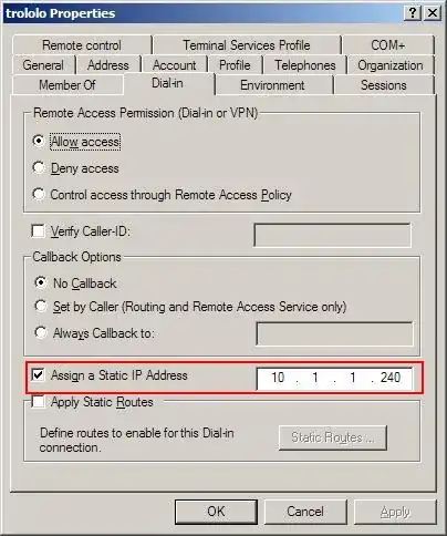

If you need to get involved in the VPN user sessions, set the correspondence between the user's login name and IP address of the VPN client.
VPN Active Directory properties
Use the internal DHCP + WINS + DNS. Not VPN Server DHCP range.
