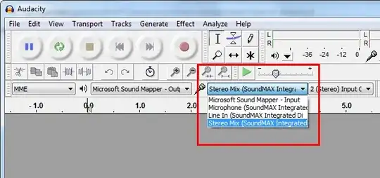

I am not sure how many of these steps have been completed yet, but I will try to cover the essential steps
Make sure that you have stereo mix output enabled in Recording Devices
You can right click on in the box to show Disabled and Disconnected devices. To enable a device, right click on it and select Enable
Recording Devices
In audacity, ensure that you are recording from the Stereo mix source
Audacity Source
If you click the record button, Audacity should now record a stereo track of whatever is being output by your computer.
If you have further problems ensure that
  1. All other sound devices are unplugged from your computer.
  2. Speakers/Headphones are enabled as the default playback device.
  3. Your audio drivers are up to date.
  4. All other recording devices are disabled
