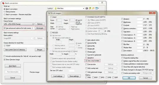

IrfanView has a similar feature, although it's a bit more hidden. Under Options > Properties/Settings > Browsing/Editing you can set the tolerance value for auto crop borders:
You can batch auto crop via File > Batch conversion:

  • I've tried these but none of the tolerance between 0 and 128 and bg settings (which were both a little ambigous for me btw in what they mean) do any good for my set of images. I didn't know PS have an auto-crop plugin but I don't have PS either. :) – n611x007 Jun 30 '13 at 09:43
