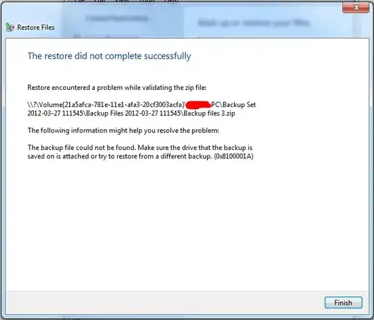

When trying to restore files using Windows 7 Backup & Restore, I get this error:
It doesn't appear to matter what backup date I try to restore from. I always get this message. Quick research takes me to lots of other people asking the same question, but it always boils down to using sdutil.zip to rebuild the MediaID.bin file. However, where the heck do I find this file?

  • 1.st make backup of your current files then try this. => http://support.microsoft.com/kb/940263 (It refeers to vista but should work for windows 7.. | or do it manually => http://windows.microsoft.com/en-US/windows7/Manually-extract-files-from-a-backup – Homer Simpsons Jul 06 '13 at 02:35
I cannot talk from personal experience, since I avoid the very buggy and fragile Windows Backup at all cost.
The best I can do is offer a link, that, ahh uhm.. , yes, I googled for :
Procedure to Rebuild MediaID.bin for Restoring Backups.
The blog contains a download link to a utility, but as this requires registration I didn't follow through.
The described procedure and utility are reported as working, although an additional advice was to run the command prompt as administrator and to use the root disk letter of the backup drive.
In the future, I suggest instead of Windows Backup to use a free utility such as AOMEI Backupper.

The answer to your question can be found here: http://answers.microsoft.com/en-us/windows/forum/windows_7-performance/getting-an-error-0x8100001a-while-trying-to/1472d543-eec2-4ccf-a2d1-c8b0019c1c8c?page=2
You must ensure that your backup volume letter matches the letter at creation of the backup. If you've not recorded this information you can use sdutil.exe which will fail but tell you the volume letter it is looking for.
harrymc's answer may be the best option, but I haven't tried it out due to the fact that, in my haste to restore the data in the backup, I've found a work-around that let me get by data back with a lot less steps. My approach doesn't repair a corrupted .bin file, though, so it will not be useful to anyone who wants to continue backing up their files to their current archive. For me, it was much easier to restore my files and just create a new backup job. I am sure most of my problems could be solved by not using Windows backup in the first place, but it's free, I already have it, and isn't that bad, so I'll continue to use it.
Here are the steps I took:
  1. Right-click my backup archive and select Open from the context menu
  2. Open the archive folder I want to restore from (Backup Set 2013-05-16 121237)
  3. Search for *.zip to display all zip files in the archive
  4. Lasso up all zips and extract them to another folder
So far, this was all I needed to do to get my files back in a pinch.
