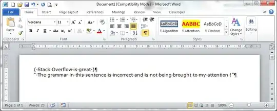

Great question.
My first thought would be to suggest disabling the grammar check as you type:
How to disable grammar checking whilst typing.
Go to the MS Word Options screen, select Proofing and scroll down a little to reach this option; uncheck the box and press OK. This will disable the annoying green line that always appears:
With grammar-checking-whilst-typing disabled.
I have shown formatting marks so that you can clearly see the spaces at either side of the bracketed section, plus also included some (horrendous and cringeworthy) grammatical errors to show how this works.
This way, you can type what you like and the grammar will be ignored. The only warning I would issue would be to keep an eye out for any unintentional grammar mistakes if you are working on something important!

  • Thanks for providing an answer. This has been here for some months and nobody provided any answer. The only problem as you already mentioned will be all grammar rules will be ignored and not just the specific one. Thanks again and of course +1 for the answer. – Anmol Saraf Oct 24 '13 at 09:52
  • You're most welcome; this is the first time that I have seen this question and am very surprised that nobody else had even attempted an answer! Thanks for the +1; if it has helped/resolved your issue, then would you mind kindly selecting it as your chosen answer? – SnookerFan Oct 24 '13 at 09:56
  • Sure @SnookerFan. I would just like to wait a little more time if someone can provide a solution which only stops the specific grammar rule and not all rules. Otherwise of course I will select yours as my answer in some time. – Anmol Saraf Oct 24 '13 at 19:09
