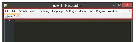

I like the look of Sublime Text 2 but I prefer using Notepad++ as my default text editor. Is there a way to make the notepad++ application itself dark? More specifically, I would like to change the region highlighted in red to a dark background with a light grey text.
I am on Win 8 (x64).
Thanks in advance!
BustedSanta

    I don't think NP++ supports this. Unless you are interested in changing the colours of *all* windows, to affect only a single program you'll probably need something like WindowBlinds' per-app skinning ability. – Karan Jul 10 '13 at 00:19
  • Hey Karan, thanks for your feedback. What you're saying makes perfect sense. I've tried to find an answer online but couldn't find anything. – BustedSanta Jul 10 '13 at 00:23

Notepad++ 8.2 - January 2022
Made a fresh install on a new Windows 10 PC. In Settings > Style configurator I chose the same dark theme I was using, but only the editor had that dark theme. The menu bar and toolbar didn't.
I'm sad and ashamed to say it took me quite a while of looking around (but wrongly focusing on the style configurator) to realize that there was a Dark mode setting in Settings > Preferences > Dark mode that you need to enable. Maybe this can help other people.
Final appearance (for reference I'm using One Monokai theme with Dark Mode enabled, cyan tone)
MonkeyBack

Ignore all these garbage answers that tell you to download and do jump thru hoops & loops. Just go to Settings/StyleConfig/Select Theme as Dark Black and you are done. Im sure there was easier solution for my fav. editor than all the convoluted answers I found.
Credit: code2care.org
