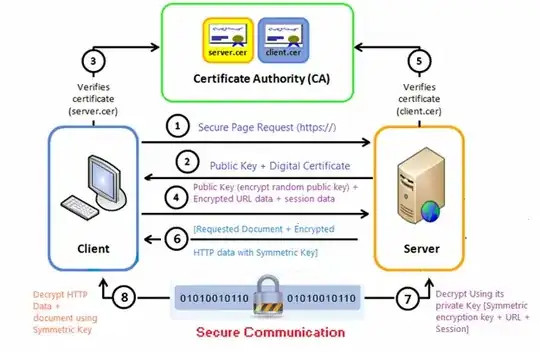

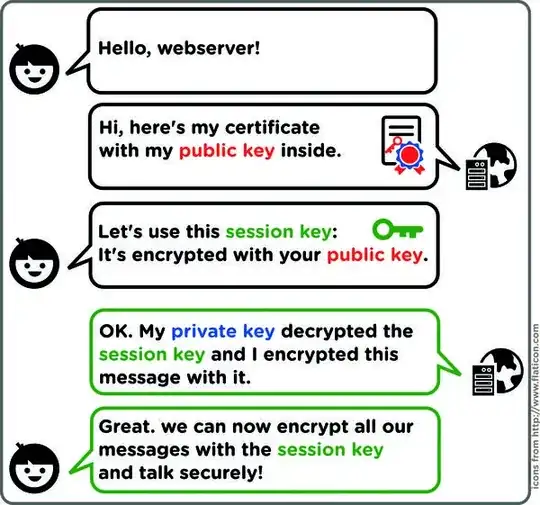

175
These two pictures together explained everything to me:
Source: linuxvoice
Source: infosecinstitute

    Nice. 1 clarification: the 1st pic is standard (1-way) TLS auth; the 2nd, mutual (2-way) auth. And 1 extra call-out in the 1st one would further help explain how the trust is actually established (all in that 1 friendlier-looking pic): after the client gets the server's public key cert, the client verifies that the CA that signed the server's cert is contained in the client's private list of trusted CAs (establishing that now it also trusts that CA). Then, it's safe to send the server the session key, w/ which each can now both encrypt and decrypt subsequent communications. – galaxis Oct 13 '18 at 18:04

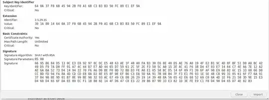

You can download open the private key file and certificate file, you see certificate file contains much information as shown below. enter image description here enter image description here
You can match your generated certificate (opening by a text editor), and private key (opening by a text editor) from this site: https://www.sslshopper.com/certificate-key-matcher.html
