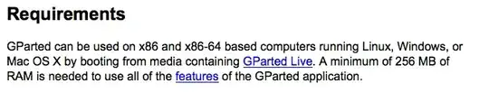

You cannot install GParted on Mac OSX. You will have to use the Live Version. This is according to the GParted website itself.
Here is a screenshot of it:
GParted Requirements
You can definitely find GParted alternatives for Mac OSX here. I found something interesting here, that parted does not even compile for Mac OSX.

  • As of today the website indicates that MacOS is supported – mreff555 Jul 10 '18 at 00:46
  • @mreff555: Today also it doesn't. It quotes "Mac OS X by booting from media containing GParted Live." – aliasgar Aug 22 '19 at 13:42
