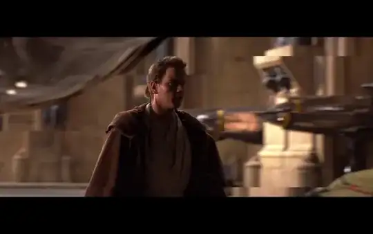

When I'm watching 720p or 1080p HD .mkv containing a H264 MPEG-4 video in full screen mode (VLC, mplayer) I'm frequently seeing strange lines, that are little bit annoying. They appear as I guess on key frames.
Here's a screenshot. Because it's impossible to describe the issue. Take a look at Obi-Wan's forehead: enter image description here

  • 1. It seems unlikely that those are keyframes. They should be *anything but* keyframes. 2. What is the video codec? That is more important than the fact that it is a .mkv. 3. Have you played this on another device to check it? – A.M. Aug 03 '13 at 22:34
  • 1. Probably 2. Codec: H264 - MPEG-4 AVC (part10) (avc1), 1280x546, 23.976215 FPS, Planar 4:2:0 YUV 3. I tried to play it at work on Intel Core i7 3770K's integrated GPU. 4. Every single 1080p or 720p video I tried has same tearing problems... –  Aug 04 '13 at 03:16
It looks like vertical tearing to me, which means that your GPU is pumping out frames faster than the screen can display them. This is typically a more common issue with games and other interactive things, since video playback typically has V-sync enabled.
If you're using GPU acceleration in VLC, try turning it off ("Inputs and Codecs" tab in Preferences, there's a "GPU Acceleration" checkbox) and see if it makes a difference.
You can also try forcing V-sync driver-side and see if that makes a difference.

    Yep, its screen tearing. Enabling V-Sync will help. – Keltari Aug 04 '13 at 03:17

  • Hmm, looking at the screenshot closer, it looks like they aren't straight tear lines, they're square blocks of the video starting at the top left and moving to the bottom right. So it may not be related to hardware V-Sync, but the issue is most likely still something related to the updating and rendering not being in sync, maybe at a codec level or elsewhere, which sadly isn't my strong suit. – Robert Rouhani Aug 04 '13 at 04:37

This doesn't look like an issue with any specific frame. Rather, it's probably your video card being too overwhelmed to display the video without lagging. Do you notice more tearing with higher-resolution videos? More pixels means more work for your hardware. High framerates can cause also more work, as it has less time to process all those tiny pixels in a given frame.
You should try experimenting with different Video Output drivers. IDK about VLC, but Mplayer does best with XV. If you and use XV with so-called "adaptors", that may help improve your performance even further (eg, -vo xv:adaptor=0). If you still experience tearing, you can try using software scaling to reduce the resolution (-vf-add scale=720), if you have a fast CPU.
