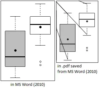

I used MS Word 2010 to save a document as a .pdf file, and some of the images have strange, extra lines on them. This happens whether the source document is a .doc file or a .docx file:
Can anyone explain what is happening, and what I can do about it?

I have also had this problem using images from R Studio copied as Meta Files. An easy quick fix is to use the "Set Transparent Color" tool in MS Word and select the background color of your figure.

I finally found a solution to this:
  1. Click on the image in the MS Word document
  2. Copy
  3. Open MS Paint
  4. Paste
  5. Save as (new image file)
  6. In the MS Word document, insert the new image in place of the original
...or, in short...
Save the image again, making sure there is no transparency in it, then insert it into the document.
The reason this worked is that the original image contained some kind of transparency layer or some transparent elements, and MS Word was not dealing with those properly. MS Paint cannot handle transparency, and in this case that is actually a good thing, since this means it will always save an image with none, which will play nicely with MS Word's save-to-PDF engine.
The way I found this out was with my first tactic of opening the document in LibreOffice and saving to .pdf from there. That actually did handle the images properly (no strange, extra lines in the output .pdf), but caused other problems (broke some formatting). The big clue that the image was part of the problem is that every time LibreOffice saved to .pdf, it threw an alert that was some kind of warning about image transparency.
A little more background info: I got the original image from R (the statistics program), saving it straight from the graphics window ( File > Save as > Png... ). R apparently generates images with transparency (with no notice to the user).

I was having this issue when embedding .emf image files from ArcMap 10.8.1. Some additional polygon features were showing up when saving as .pdf; vonjd's suggestion to print as .pdf was the most useful workaround here in terms of simplicity, removing apparent transparency, and preserving image quality.before after
