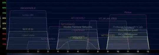

Take a look at the following image. 802.11b and 802.11g have slightly different wireless signatures. 802.11b looks more like a bell, where as 802.11g has a more rectangular shape.
Basically the transmission occurs on the actual channel but the transmission 'over flows' onto nearby frequencies. The same thing happens in your car when you can still hear a radio station if you tune 1 frequency up or down. enter image description here
