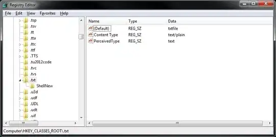

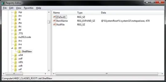

I gained access to another PC running Windows 7, a computer on which the context menu was intact. I peeked at the registry of this machine and copied exactly what was entered. Doing so resolved the problem on my desktop with the broken context menu.
Following all the instructions listed above, the two Strings within the .txt key that I needed were Content Type and PerceivedType.
So then to recap, if you are facing a similar issue, here is what I did to fix this problem. Hopefully it works for you as well.
(First backup the Registry.)
  1. Open regedit.exe
  2. Expand HKEY_CLASSES_ROOT and look for a .txt key. If none exist, create one.
  3. Within the .txt key, create two new Strings: Content Type and PerceivedType.
  4. (Right click) Modify... and the value for Default should be txtfile.
  5. (Right click) Modify... and the value for Content Type should be text/plain.
  6. (Right click) Modify... and the value for PerceivedType should be text.
  7. Create a new key with the name ShellNew within the .txt key.
  8. Within the ShellNew key, create a new String with the name NullFile.
  9. Within the ShellNew key, create a new Expandable String Value with the name ItemName.
  10. (Right click) Modify... and the value for ItemName should be @%SystemRoot%\system32\notepad.exe,-470
Here are two screenshots of what the final outcome should be:

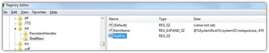

21
Create a new file with the .reg extension, copy, paste, save and run.
; clear the key
[-HKEY_CLASSES_ROOT\.txt]
; and recreate
[HKEY_CLASSES_ROOT\.txt]
"PerceivedType"="text"
@="txtfile"
"Content Type"="text/plain"
[HKEY_CLASSES_ROOT\.txt\ShellNew]
; @C:\Windows\system32\notepad.exe,-470
"ItemName"=hex(2):40,00,43,00,3a,00,5c,00,57,00,69,00,6e,00,64,00,6f,00,77,00,\
  73,00,5c,00,73,00,79,00,73,00,74,00,65,00,6d,00,33,00,32,00,5c,00,6e,00,6f,\
  00,74,00,65,00,70,00,61,00,64,00,2e,00,65,00,78,00,65,00,2c,00,2d,00,34,00,\
  37,00,30,00,00,00
"NullFile"=""

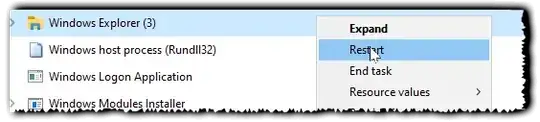

    Also, restart explorer afterwards (or just reboot) – dlf Jun 21 '15 at 13:58

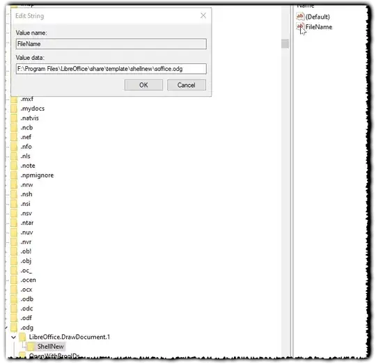

Removing Unwanted Context Items That Block New Text Document Entry
As explained in some of the other answers, Windows only allows a certain number of items in the right click New menu. So even if you have the .txt registry correct (as explained in the other answers), you may not see the Text Document entry in the New menu. Here's how to delete the extra entries.
  1. Open Regedit.
  2. Click the File -> Export -> All. Click Save to make a backup of your registry in case anything goes wrong. enter image description here
  3. Navigate to Computer\HKEY_CLASSES_ROOT

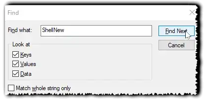

  4. Press CTRL-F to Search and type in ShellNew. enter image description here
  5. Press F3 or Click Find Next.
  6. When it stops on a "ShellNew" key, check the contents of the value ItemName (or it may be named command or FileName)
  1. If the path shown is not for a file type you want in the context menu, delete the corresponding "ShellNew". Don't Delete any Keys which are not named simply "ShellNew".
  1. Repeat 5-7 until you have deleted all the other unwanted ShellNew entries.
  2. Check Your Context Menu To Verify .Txt Shows UP.
  3. On Windows 10, you should be able to see the changes immediately, if not, try restarting the Windows shell using Task Manager: enter image description here
  4. Test by right clicking in a folder you have permissions too (like the Documents folder). If you don't have permissions (e.g., in the root c:\ directory) you will see little if anything in the New menu. enter image description here
