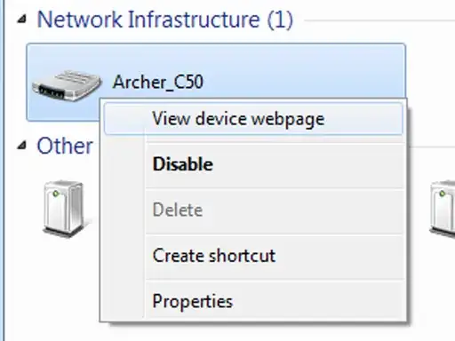

None of the above command-line options worked for me, but I was able to successfully find my IP by doing the following from the Windows 7 GUI.
From the Start menu, search for View network computers and devices. In the window that opens, look for Router 1's name or brand name. Right-click on it, and click View device webpage - this will immediately open the router's gateway address in your browser, with its gateway IP in the address bar.
Hashim Aziz
