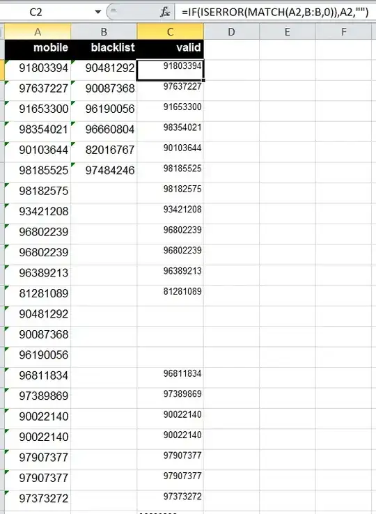

After using this formula =IF(ISERROR(MATCH(A2,B:B,0)),A2,"") in column C, it nicely filters out the blacklisted numbers.
But I need advice for a step further: How do I remove duplicates?

You can change the formula to:
=IF(ISNA(MATCH(A2,B:B,0)) * ISNA(MATCH(A2,C$1:C1,0)),A2,"")
It won't display duplicated records. You can then use AutoFilter, excluding (Blanks), and copy&paste values to a new sheet.
