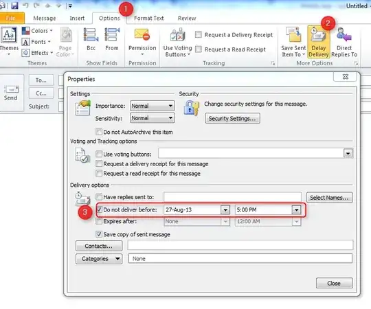

I need to send some emails at a specific time of the day and need to do it every day. How can I do it with Outlook?
Delay delivery helps to send mail at a specific of time; but how to create new mail to be sent for tomorrow?
