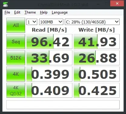

I do all my immediate read/write operations for content generation in RAM disks on my local machine. I also store my MongoDB journaling folders there, as well as my compilers and Python interpreters and standard library. This disk is saved on shut down and restored on start. The second RAM disk I use is 64 megabytes and all my internet browser's cache folders point there; that one is lost on shut down, and flushes itself when it's full.
Use the right tools for the job I suppose, would be the answer I give you. I'm generating data 30-1000x faster using a RAM disk than on my 7200rpm Western Digital.
This is the program I'm using: http://www.romexsoftware.com/en-us/primo-ramdisk/
...and when 32gigs of Ram is less than $200, I don't see why this isn't becoming more common.
8 gig RAM diskeveryday SATA III HDD

    You know that the OS caches things for you already, right? – Potatoswatter Aug 28 '13 at 09:44
  • *"when 32gigs of Ram is less than $200"* 32 GB on a 1 TB HDD starts out at around $3, give or take; consumer 1 TB drives go for less than $100 today, and even enterprise grade drives can be had for similar per-gigabyte prices (Amazon wants $408 currently for the 4 TB Seagate ST4000NM0043 which sports a RRP of $520, and that's single units without even shopping around). – user Aug 28 '13 at 09:52
    @Potatoswatter yeah, it does. But it doesn't cache 10,000 newly created files. So, I explicitly "cache" them on my RAM disk. – blakev Aug 29 '13 at 17:36
  • @MichaelKjörling We're not trying to store 1 TB in RAM. That's ridiculous. Be realistic and pick a few key folders you always want to have in RAM and you can SIGNIFICANTLY (orders of magnitude) speed up certain operations in your workflow. See my images above. – blakev Aug 29 '13 at 17:38
  • Copying from the question: *"on power up, load everything to the RAM from the hard drive/SSD and just run everything from there"* That seems to me to imply reading *everything* off the hard drive into RAM (and it's also the basis of a lot of the other answers to the question). Also, if you look at my comment again, you'll see that my point was that "32 GB of RAM is less than $200" is *hideously expensive* compared to secondary storage such as a HDD. – user Aug 29 '13 at 18:39
    "everything" is relative. On my machine, it does load "everything" from my 8 gig hard drive image; byte for byte the entire 8 gigs is cloned every time. For the sake of the question, if you're looking for a solution to *really* do this would you stay within "possible" or blow it way out of proportion to fit a "that's impossible" type of answer. – blakev Aug 29 '13 at 18:44
  • Nice. Yet even that 32GB cap is unfortunate :/ – Lorenz Lo Sauer Aug 29 '13 at 21:04
  • @LoSauer the most RAM I've seen in a "day to day" computer is 64 gigs Quad-Channel DDR3 2100. Server motherboards can handle a few times that amount. The software I linked to can utilize it as well (linux comes with the ability built in :) ) -- possibilities are there. RAM disks are just my perfect solution for file IO staging. – blakev Aug 29 '13 at 21:28
  • @BlakeVandeMerwe If it doesn't cache new files, it's probably broken. A cache usually stores whatever was recently accessed. Really what you're saving here is the cost of flushing the cache, but how often that's done should be configurable at least on Linux. – Potatoswatter Aug 30 '13 at 11:21
  • @blakev _Your_ 32GB cap. Someone who puts 32Gig in, likely has no qualms about stuffing 64Gig in :) – Lorenz Lo Sauer Sep 01 '13 at 13:03
