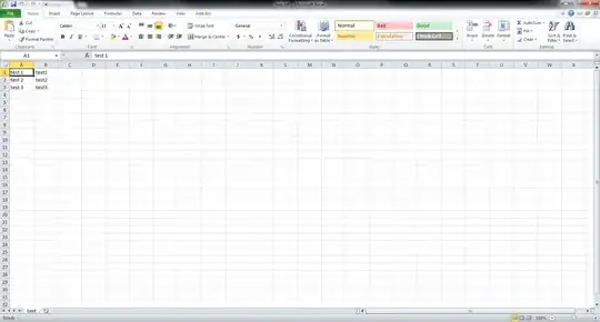

This is not exactly what you're looking for since it does not use Notepad++, but if you're open to using MS Excel, it'll help with getting what you need on the clipboard in one go.
Open the file in MS Excel and follow the procedure below:
  1. Choose the option 'Delimited' enter image description here
  2. Set the delimiter as - enter image description here
  3. Click 'Finish' and you're done! enter image description here
Roney Michael
