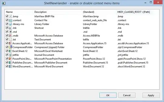

ShellNewHandler shows the markdown extension. Do I have to somehow add a template file?
ShellNewHandler screen capture

Finally, from ShellNewHandler you may have to:
  1. uncheck .md
  2. apply
  3. check .md
  4. apply
