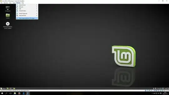

It's an old question,but today I faced with the same problem with Linux Mint 18 (Sarah) Cinnemon + Oracle Virtualbox Version: 5.0.10 r104061. (Host OS is Windows 10.)
I used 3D acceleration as you, so this was not the problem.
I am new with Linux and Vbox, so maybe it is not the whole thing, but after I have run the Guest Additions, Mint could run in normal mode (not in Software Rendering Mode).
Steps:
  1. Start Linux Mint machine in Vbox
  2. Choose: Devices / Insert Guest Additions CD image... (see picture in the link below)
  3. Run it
  4. Reboot Linux Mint machine
    This solved my problem. I hope, it will solve others' problems, too.
    See the image here.

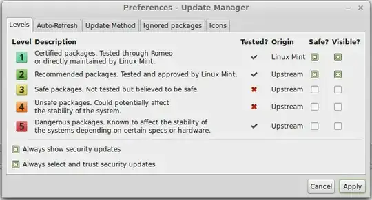

This seems to be an issue with VirtualBox Guest Additions 4.3.8-4.3.12. It seems that 4.3.13 fixes the issue. , though I cannot find an available pre-RC ISO any longer.
Sources:
Update: I was able to bypass the issue using 4.3.10 that is packaged with Linux Mint 17 by avoiding the untested updates which contained several updates to mesa and opengl. I had no issues by sticking to the security updates until 4.3.13 is officially released.
Imgur
