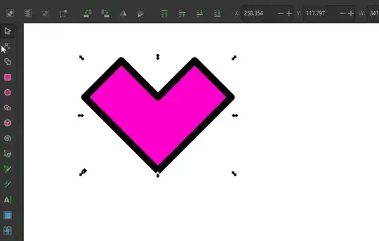

I've had success with just using Bezier curves. E.g. I would draw the OP's L shape like
   \_________
(very rough ASCII art!) i.e. with a diagonal line where the rounded corner should be, and then adjust the Bezier control points for the two line join points.
Another method is to create a stroke and set the Join and Cap to be rounded. Copy the path and paste in place and remove the stroke from the copy. Then select the original and select path > stroke to path then union the 2 shapes back together.

Select the path that you added the effect to using the path selection tool, which has an icon that looks like this:
NOTE: The icon may be different, it all depends on the icon-theme your instance of inkscape is configured to use, but the icon will be similar either way
You can confirm that it was added because a bunch of options will be made available in the Path Effects Dialog. You should also see green nodes on your path where ever there is a corner. will have green nodes if you select the edit path tool which looks like this
Using the Rounded Corners Path Effect
Below is a 3-image set, each image is useful.
FIRST IMAGE Image
First image shows an odd object, notice that the nodes are green? The green nodes are Inkscape's indicator that the path-effect is active.
Troubleshooting the Rounded Corners Path-effect
  • If you have no nodes then you are not using the path-selection tool.
  • if you have nodes, but they are not green, then you have failed to activate the path effect.
  • If you have only a single green nodes, or the nodes aren't where you expect them to be, its probably the wrong path effect.
Dragging the Green Nodes
To use the path-effect, select any number of green nodes, then drag them. In the image below, I choose an odd shape, the type of shape that is difficult to round symmetrically. It sorta looks like an axe with a point. To round the point I have selected the node, and dragged it back. Before I let the node go, I took a screenshot, this is that screenshot. enter image description here
The final result.
You will get results as shown below if you follow the instructions correctly
