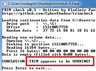

I wrote a command line program to check if TRIM is enabled:
Download & source code
trimcheck
This program provides an easy way to test whether TRIM works on your SSD. It uses a similar method to the one described here, but uses sector calculations to avoid searching the entire drive for the sought pattern. It also pads the sought data with 32MB blocks of dummy data, to give some room to processes which may otherwise overwrite the tested deteled disk area.
The program will set up a test by creating and deleting a file with unique contents, then (on the second run) checks if the data is still accessible at the file's previous location.

    [The SSD Review](http://thessdreview.com/daily-news/latest-buzz/trimcheck-does-your-ssd-really-have-trim-working/) and [TweakTown](http://www.tweaktown.com/articles/5203/trim-check-overview-of-an-essential-ssd-trim-functionality-tester/index.html) have published an article about TrimCheck. Hopefully it is better than "getting an email with the attachment YourAnswer.exe" now, Dan Hook ;) – Vladimir Panteleev Feb 28 '13 at 23:35
