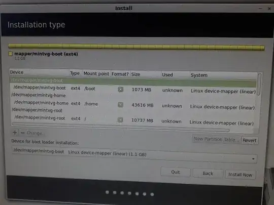

When I reached the partition step in the Mint 15 installation process I saw the screen as shown in the three photos below.
Each of these three pictures shows (in the dropdown at the bottom of the image) three different choices I have tried for the bootloader installation. All three of them has the same result: the BIOS cannot find anything bootable when I select the physical drive (i.e. the 64GB Sandisk SSD, device sdc) as the boot device.
First choice of location for bootloader installation
Second choice of location for bootloader installation
Third choice of location for bootloader installation
If not in any of these three locations, where should I be installing the bootloader in order to make this installation bootable?

You should install /boot partition outside of LVM, and tell grub to put its files there (and its bootloader part in MBR, if it asks).
That is, create smallish /dev/sdc1 as type 82 and put /boot on it, and then create /dev/sdc2 as type 8e and put LVM and other partitions on it.
