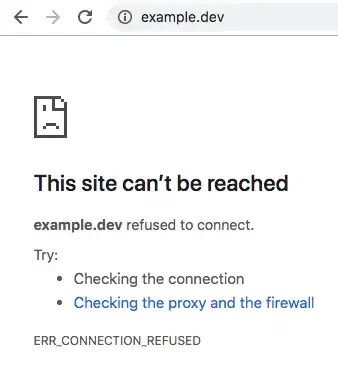

I stumbled upon this question by thinking that the hosts file didn't work on Chrome for macOS for the .dev fake domains I use for development.
Actually it does work, at least on Chrome 77.
The issue is not that the domain is not found, but that all .dev are now automatically redirected to https:
This site can't be reached - Chrome
If you double-click on the domain name, you can see the culprit:
https
Now that Google broke our .dev, as a solution, the link above suggests to move to another TLD for development, like .test or .localhost.
