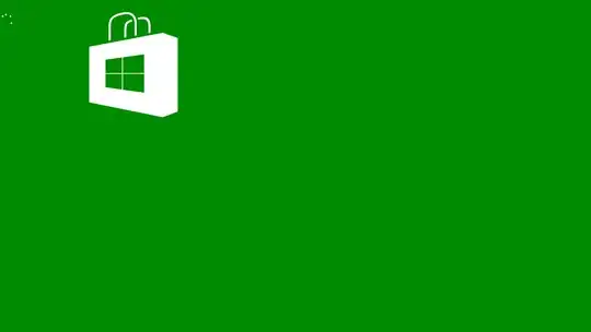

Most of those Metro apps on my Windows 8 computer won't open. It looks like the internal renderer is broken or something like that. Here is some screenshots.
This is the store app. The logo and the loading gif is floated toward the left side.
This is the Skype app. The logo doesn't even show up.
I have tried the App Troubleshoot program but the issue persists.
As far as I know, the so-called Metro Apps uses HTML and JavaScript, which basically is a webpage with an extra command shell. (Bad decision, Microsoft.) Is there a probability that the renderer is broken?
Here's the Weather app: enter image description here
Derek 朕會功夫
  • 334
After I digged into the problem, I figured out that it is because JavaScript of IE was turned off by my antivirus. I uninstalled it and now everything is back to normal again.
