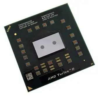

I'm confused. I own a Acer 5542G notebook with an AMD Turion II X2 M500 CPU and ATI Mobility Radeon HD 4570 GPU. This computer has been overheating a lot lately (even playing Minecraft for a few minutes would trigger a system shutdown) and I just recently took it apart and cleaned it.
There was no dust accumulating on the fan grill, so I removed the thermal compound, cleaned the CPU surface and applied some new compound. I used the "pea method". My CPU has a rectangular surface so I applied two little pea-sized dots.
Where I used the thermal compound
After I did this, I ran CoreTemp and here's what I saw (idling temperatures): CPU running super hot!
That's a lot of heat! I'm guessing I screwed with my application of the thermal paste. I'm hoping anyone who owns an Aspire 5542G or a computer with an AMD Turion X2 M500 processor that has experienced the same problem could help me out here. Thank you.

  • Thank you for the suggestions. I did check the air vents and they're clean with no dust in them. Anyway, I disassembled my notebook again today and cleaned off the thermal paste that I applied earlier using the "pea" method and reapplied some new thermal paste (this one had greater viscosity) using the "business card" method and it's running WAY cooler now. The CPU now idles at around 65 degrees, almost 20 degrees cooler than the earlier 85. I also took some pictures of the CPU with new thermal grease applied to it and I'll add them to my answer. – Vinayak Oct 02 '13 at 15:32

As Debra and Sirex suggested, I decided to go with the "business card" method of application of thermal grease and this is what my CPU and GPU look like now:
Viscous thermal paste applied to CPU and GPU using "business card" method
After I reapplied the thermal grease, my computer's idling temperature dropped by almost 20 degrees and even under high load (I used Prime 95 for CPU stress testing) it wouldn't cross 90 degrees.
