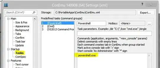

I know I can add additional "tasks" to conemu but I want it to default to use Powershell instead of cmd.exe so that, for example, when I use a plugin for an IDE that opens conemu in the current working directory, it does so with a conemu-wrapped Powershell instance.

Assuming a "{Powershell}" task:
Use the Startup tab and assign Powershell under "Specified named task":
If you want to start in a specific directory, change the task definition like so:
Powershell with default directory
nathanchere
  • 2,366
    setting default directory as explained above does not work. Try http://superuser.com/questions/482325/change-conemus-default-start-directory instead – joniba Nov 02 '16 at 12:38
  • @joniba Correct, because powershell takes any strings as a command, so quite literally it's trying to execute `D:\MyDocs`. The poster needed to specify `-WorkingDirectory` – Maximilian Burszley Apr 02 '19 at 11:53
  • Worked for me: `powershell.exe -noexit -Command "cd c:\Users\[Name]\Desktop"` – JoyfulPanda Jan 27 '22 at 13:43
