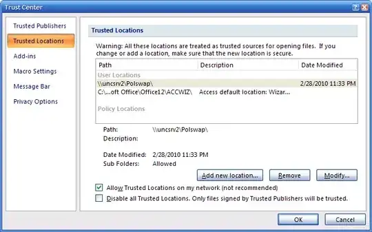

I was able to prevent this popup from showing by changing a setting in Access' Trust Center. You can access this by clicking on the Orb, then the "Access Options" button, then "Trust Center" on the left-hand side, and then clicking on the "Trust Center Settings..." button.
trust center window
In the Trust Center window, click on "Trusted Locations" on the left. In my case, the file I was opening was hosted on a network share, so I had to checkmark "Allow Trusted Locations on my network (not recommended)" before adding the share with the "Add new location" button.
You may also have to make a change in the Macro settings.
Please note, though - these warnings are there for a reason. Changing the settings above could allow malicious code to run on your computer.
