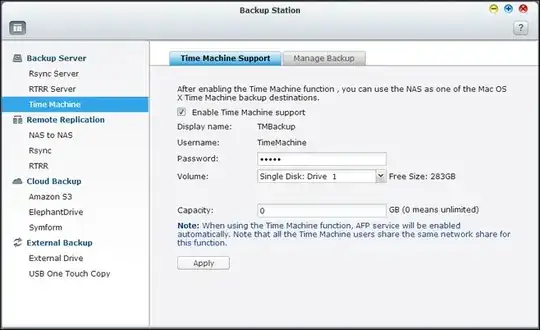

I have a QNAP TS-212 NAS running the latest 4.0.2 firmware. This firmware has a Backup Station option where it creates a Time Machine backup volume for OS X to use. In my case OS X 10.8.5.

The problem is that the Time Machine volume needs to be accessed by a different user account, namely TimeMachine. It can access the NAS via SSH and AFP. The password is the one you set in the Backup Station control panel. Other shares might be guest-only or accessible from another user, but I believe that OS X refuses the connection to TMBackup entirely if it hasn't seen that machine yet.
